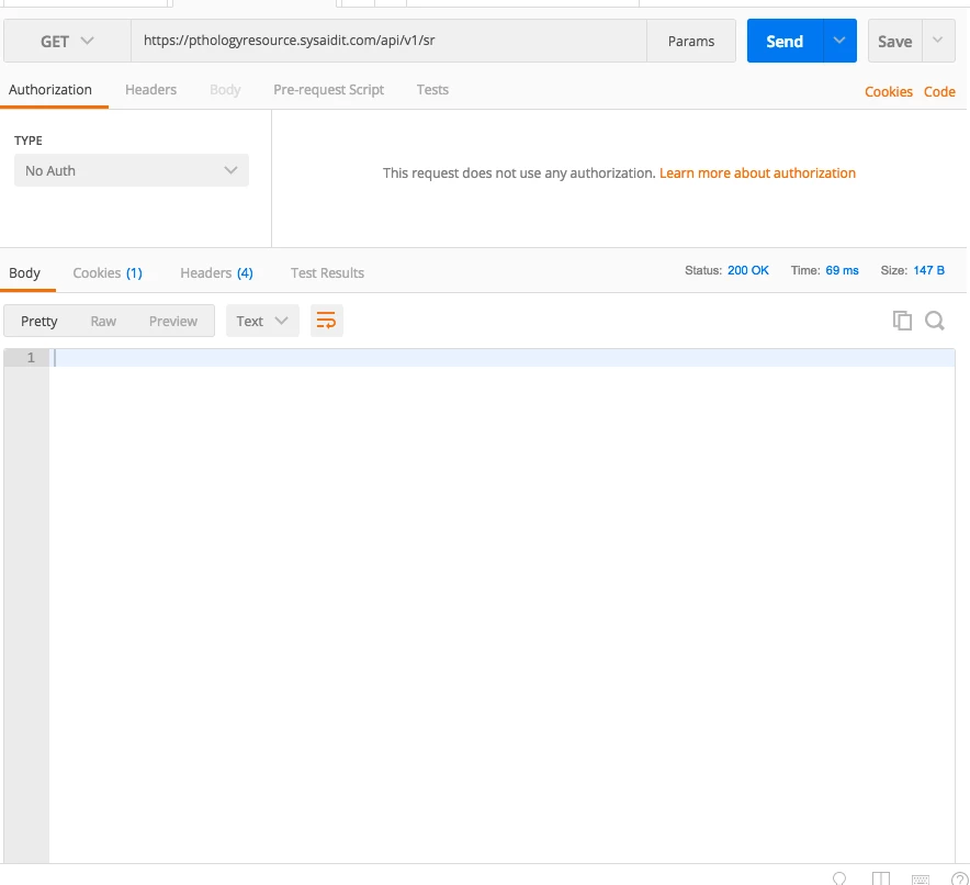

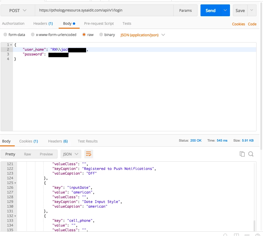

I am trying to reach my service request using the API. I can login as shown in the first attached picture but I can't perform any GETS on any of the commands; it just returns nothing, not even a blank JSON. Am I using a wrong address? Do I just not enough permission to use the API? Thanks in advance

Hi John. I know this post is old, but I thought I'd chime in. I've been trying off and on to wrap my arms around Sysaid's API's for a while and happened to come across this post. I'm not sure if you've resolved your issue or not. The GET request in your second screenshot...../api/v1/sr......is a request that returns ALL service records and all fields pertaining to those records, which is a lot of data. That request eventually times out. I ran into the same thing. The recommendation is to add some additional parameters to filter the number of records to return. If you're just wanting to see if a GET request works, you could specify a service record number to return. For example, if you have a service record SR#1234, then add this to the end of your company url......../api/v1/sr/1234. Be sure you run your POST login request first to generate your cookie, then run your GET request https://<CustomURL>.sysaidit.com/api/v1/1234. Good luck, and I hope everything works! Travis
