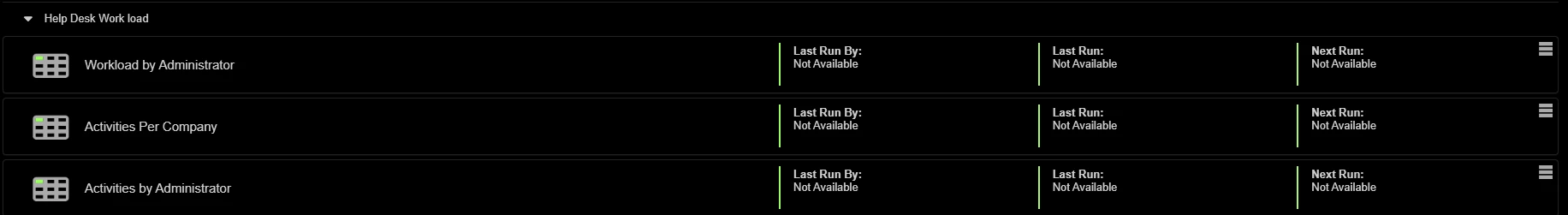

Hi there,
By default, you should have access to a report named “Activities by Administrator” (please refer to the attached screenshot).
This report will provide you with the total number of activities performed by that administrator.
Please let me know if you need any further assistance.
