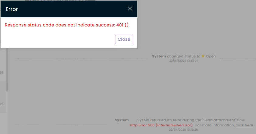

Hi,
We're trying to upload attachments via the SysAid REST API.
It works on our local environment, but fails from our public environment with a 401 Unauthorized error.
creating SR is successful.
We suspect there might be IP or domain restrictions.
Could you confirm if any such restrictions exist and help us to understand how to allow access from our server IP/domain?
Also, we don’t see a REST API settings or IP Restrictions panel in the admin UI — is it possible to enable this?
Thank you!

Hello ​@ronent
Thank you for the question.
As far as I know, there isn’t an IP restriction panel in the admin UI.
Can you share which API call you’re using and what permissions the account used for the call has? Is it a full SysAid admin?
I think the best next step is to create a ticket with our helpdesk so we can look into it more closely. I’ve already sent a message with your contact details and environment name to get a ticket opened — we’ll continue from there!
